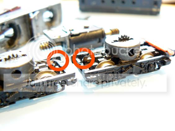

Here's a detail shot of the bogies (yes, look at that
grime
;D! I fully plan a thorough bath and lube job before this ever sees power again!). As you know, the two brass strips sticking up from the bogies contact the bottom of a small circuit board that sits below the frame and the motor.

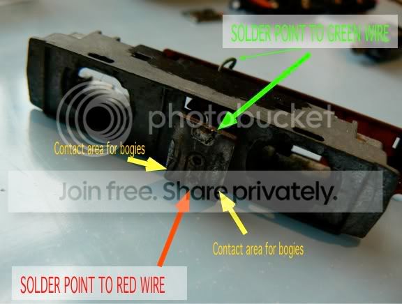

Here's a shot of the underside of the frame showing the small circuit board where the above brass contacts make contact.

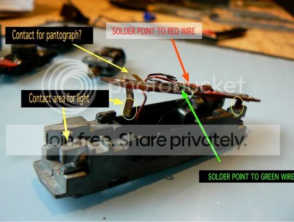

Skipping past the motor, two leads soldered to the small circuit board go to the 'large' circuit board, shown in this photo. The only purpose I see for this large circuit board is to allow power from cantenary and to transfer power to the bulbs (it seems the bulbs get the opposite polarity from the metal frame). There are two 'bracket' like contacts that snap inside the actual motor that seem to complete contact between the large top circuit board and the motor.

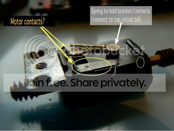

And then, the motor itself:
I think that's about it. I think (but am by no means confident) that buy just isolating the power contacts from the bogies from the frame, sending those power inputs direct to the decoder, then use the motor out leads from the decoder to the motor, and setting up new LED lights (again, direct from decoder and remove all contact with the frame), I should be good. But, then, my confidence here is about 10%, so any help is greatly appreciated!

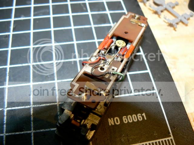

Hmm.. Could you take a picture of the main circuit board from the top, so it's a bit better to see where all the wires go?

Here's another view of the top of the circuit board
