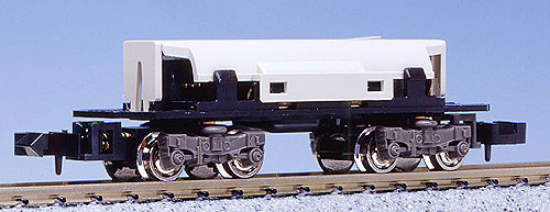

I went crazy the last time I was in Takatsuki and bought nearly 4 full trains of vehicles from the Bandai range. They're great... until I realised how much extra you have to throw in for couplers and new chassis.
I'll get some photos tonight of the fun I had with them... the locos do indeed fit the 4-wheel chassis from Kato (which come in black or grey).

Thanks Steven - would that be the "Pocket Line" chassis 11-103? I ask as I can get those easily enough here, if it's not that I'd have to order one with the train pack.
Share this post
Link to post
stevenh
...the "Pocket Line" chassis 11-103...
Correct, that is the model number.

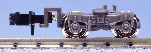

You can see the standard wheelset the passenger cars come with... these are entirely useless except for dioramas.... so there are also bogies+couplers combos for the passenger cars by Kato. I tried bolting on my own bogies with washers to space them off the plastic chassis but then the entire carriage wobbles... much easier to just buy the Kato bits and pieces.

BTW: A big note is that the chassis weighs next to nothing... meaning that their tractive-effort is crap. You can try and get them to pull 'real' cars, but they'll struggle.

Right, the options from Kato are given to you so that you can be as prototypical as possible...
So, if you want grey bogies for your entire EMU/DMU consist then you get the grey dual-bogie chassis 11-106  (2100 Yen)
and the associated bogies for trailers (11-097) (315 Yen) (2 bogies per pack)
Of course, these are also available in black.... See this link.
Turns out Hobby Search has them in black  and in grey
and so does Hobby World in grey and in black
